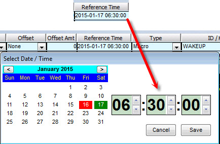

If you select "Exact" in the Timing column then you must enter a datetime in the Reference Time column. You can enter a datetime value directly in the Reference Time cell or you can double-click the cell which will open up a dialog window where you can pick a calendar date and edit the time values.
You can skip this step if your Timing column entry is one of the dynamic time choices, since the Reference Time will be automatically determined, and will vary every day.
Reference Time

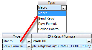

After setting up the datetime parameters, you now specify how you want to take action(s) at the scheduled time. You can choose from four different Types of action as exampled below.
Event Type
